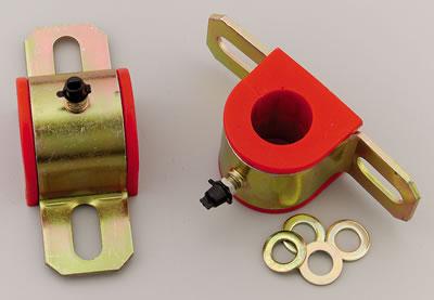

Good write up. The first winter with my Solstice I had this problem and took it back to the dealer and he greased the bushings but the next winter, the problem returned., This year I decided to replace them with greasable Prothane bushings. Hopefully I'll never have to remove the bushings again, just give them a shot of grease when needed.
Energy Suspension Sway Bar Bushing Set PONTIAC SOLSTICE 2006 - 2007 9.5160R
Note that the front and rear bushings are different sizes. The front are 1 5/16" (34mm) and the rears are 1 1/16" (27mm)

The greasable rears are easy to find I never found any for the front with the fittings, I even had a hard time finding just poly for the front, used bushings off a 2005 mustang and the stock brackets, not a squeak since.

That will quiet the squeak but silicon is a drying agent and will ruin the rubber bushing, should happen very quickly but not a good idea to use silicone on rubber. The poly bushings recommend an none petroleum based lube, like Super Lube. The other advantage of poly bushings is they improve handling and road feel for a couple of bucks.
