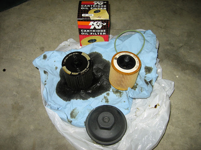

I just did my first oil change at 7200 miles, the DIC said oil life was at 12% remaining, the manual says the DIC will display "change oil soon" or something like that when it needs to be changed, but I was getting nervous. The manual also says something about under the right conditions the DIC will show you still have oil life, but if it has been 1 year to change it anyway.
I've had people tell me before that when you're using synthetics you can go 6 or 8 thousand miles between changes, but it all depends on driving conditions.
I used the K&N HP-7000 filter cartridge.
