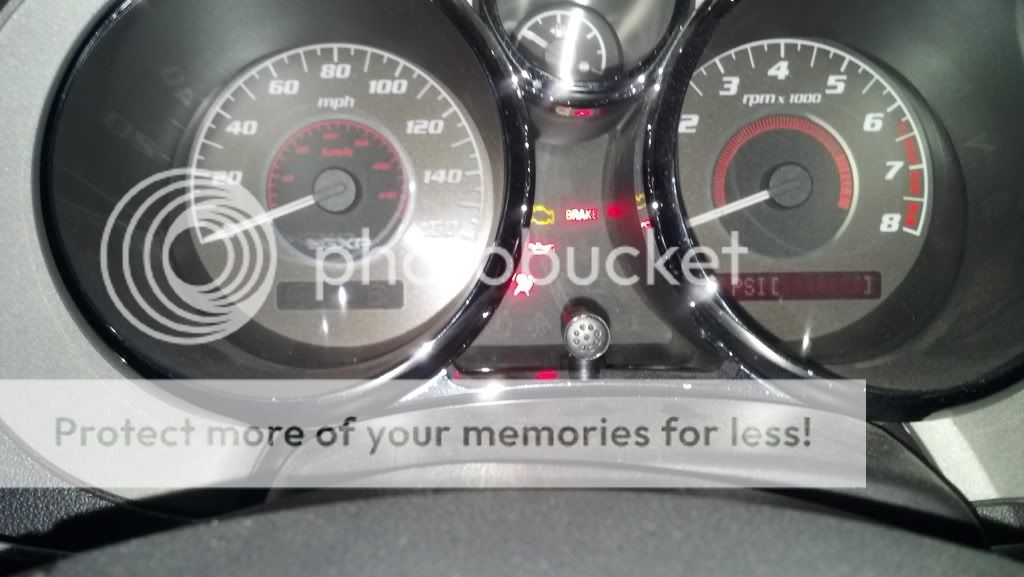

Here's where mine is. Seems like a good place, out of line of sight and away from wind buffetting. Coupes may be different air flow, but probably not much.

I don't have a picture of it but mine sits in the triangle between the two round guage bezels where the warning lights are.
This is what I was thinking, but wasn't sure just how many warning lights it would block...

The warning lights are bright enough that if one were to come on, you can see the glow. seeing around the mic to see what light is on is no problem. Also as a note, no one I've talked to with it has ever said they can't hear me good with the top down. Mine sits right where jekl's is pictured but sits in a bigger holder piece so it takes up a bit more room.
