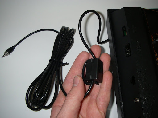

If you're going to Radioshack, pick up a pair of these ferrite chokes as well (like CS said earlier): Snap Choke Core - RadioShack.com
Then try combinations of these clipped over your signal and power cables. If they have big enough holes (I'm not sure if the linked chokes do or not) loop the cables first and clip the chokes over the paired wires part at the 'bottom' of the loop (like photo below).
Try in this order, until you find a combination that works:
  1. Over power cable alone (with original signal cable)
  2. Over both power cable and original signal cable
  3. Over power cable alone (with eBay GL isolator cable)
  4. Over both power cable and eBay GL isolator cable (try the choke in different places on the eBay cable)
  5. Combinations with RadioShack GL isolator cable if necessary
  6. ... etc.
