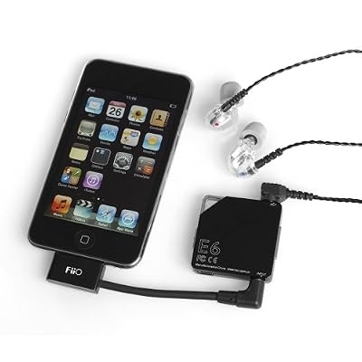

You can get a digital converter with built in amp to place between the iPhone and the input on the factory radio, really improves sound quality and cleans things up and has an eq built in.I use this one on my Harley with headphones works great.
Fiio E6 Headphone Amplifier
The adapter cable is separate about $40 for everything

Thanks for this info. This looks like a really good idea!

It uses the digital output of the iPhone that gives you a cleaner signal right off, then it has a couple of different eq curves to choose from and some amplification, it is very small.

Just ordered it!!! Thanks!!!!
