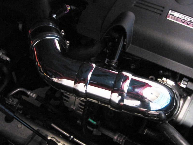

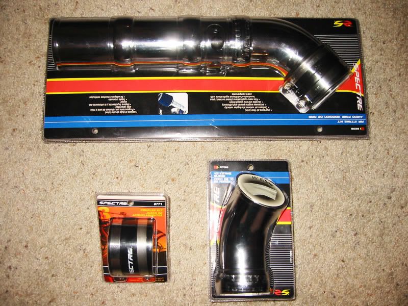

The easiest and BEST thing to buy, or to make, is your own intake while retaining the stock air box and filter. Just buy a K&N drop-n filter and replace the restrictive stock tubing/with baffles.
A good smooth inside tube(less air turbulence from stock rubber flex tube) that is 2.5" or 3" wide with couplers will work just the same if not better than any aftermarket C.A.I. because the stock air box IS completely closed up from any outside heat. There is an opening at the front lower part of the air box that points directly out and towards the front of the bumper. It gets plenty of cool air form this location.
Here is one I made with parts from my local auto parts store. Noticed how I kept the stock air box in-tacked.

That's basically what I did. When you remove the side "noise suppressor/baffle" and stock tube, you are "gutting out" the poor air flow and replacing it with a more direct path with smoother insides when using a solid long tube.
