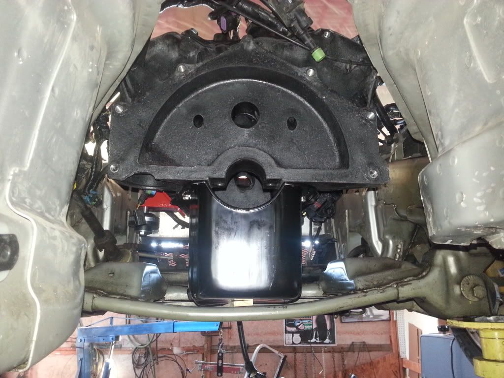

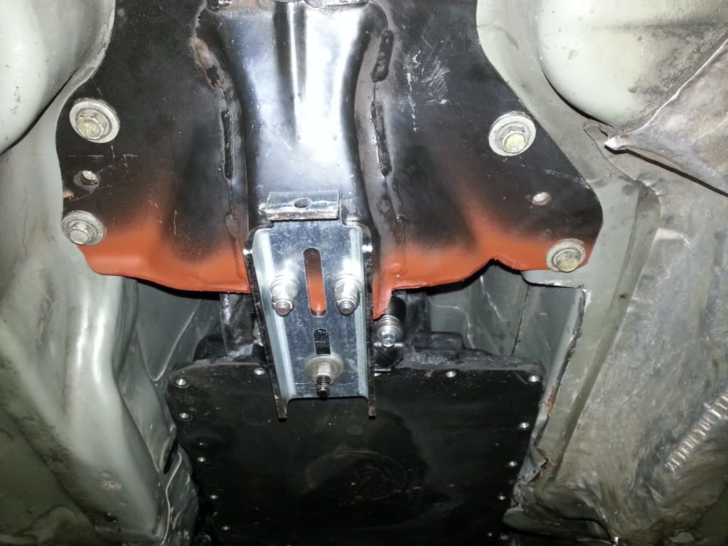

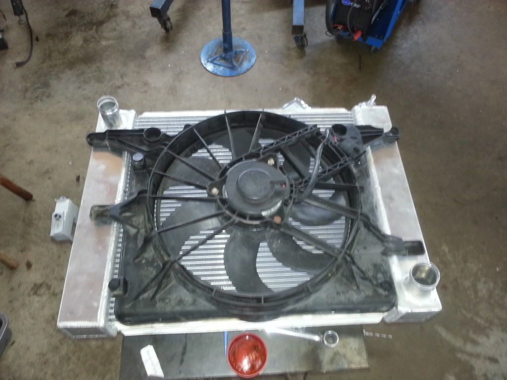

Here's a small list of what needed to be modified or replaced. Engine mounts , radiator ,coolant lines air conditioning lines, gauges, electrical, modify power steering hoses, transmission mount, driveshaft, new coilovers this isn't all I had several pages of parts in my build journal
first pic is modified factory tranny mount
Pic of mock block showing oil pan clearance to crossmember
New radiator and factory fan and yes it does cool the V8 well

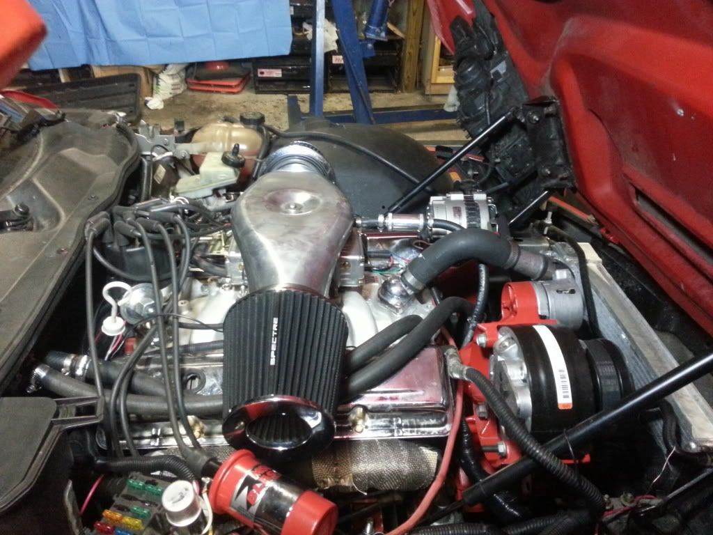

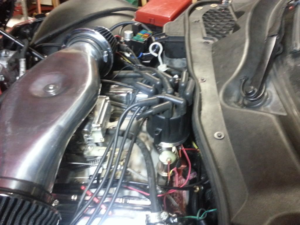

Engine bay pic just need to clean up wires a bit
Had to notch the cowl for the distributor but not much
