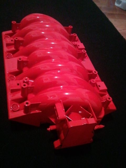

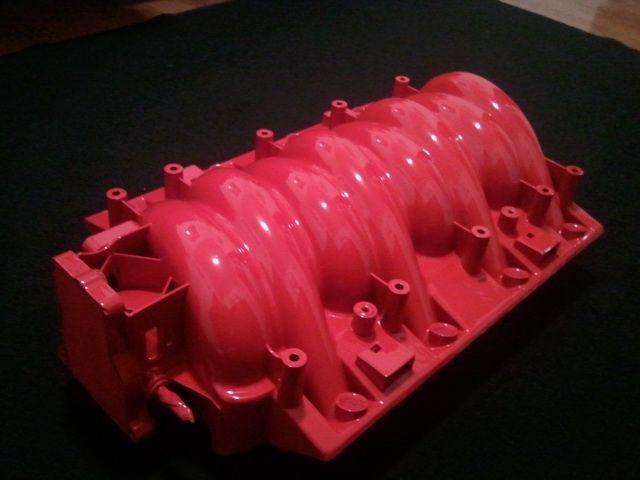

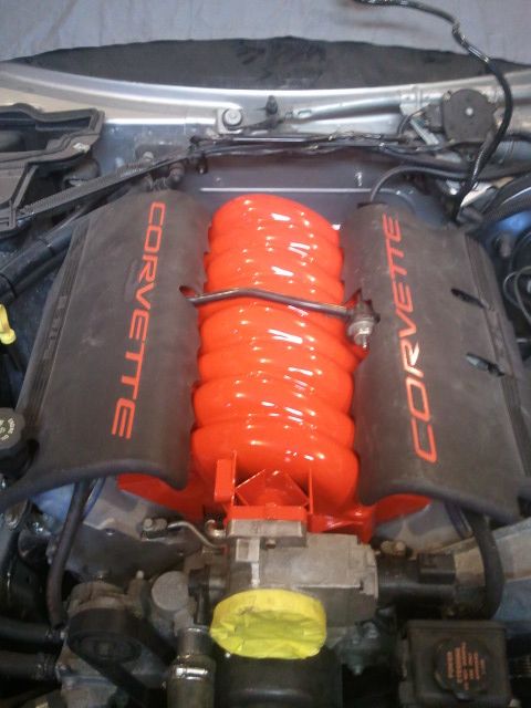

decided to take my intake to work and paint it BRIGHT red cause im a ricer at heart. might paint the valve covers eventually.

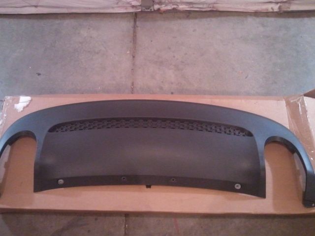

and finally got my gxp valence, omg $300 later i'm wondering if its secretly made of gold or something.

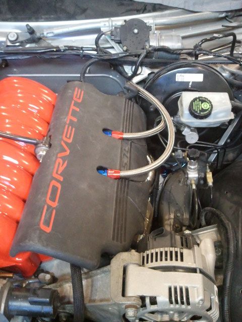

ordered some ss braided fuel line and fittings to complete my fuel set up, should be working on that in the near future as well

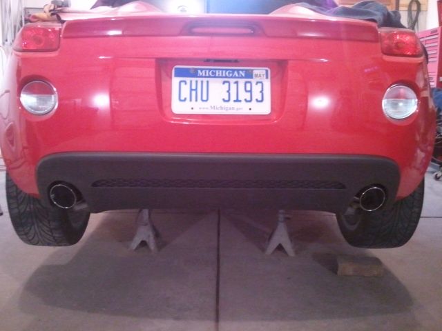

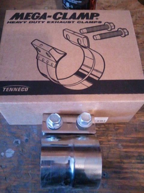

finished up the exhaust today, got my clamps in, tips welded on.
got the fuel lines set up at the rail, need to get a bulkhead for running a return line into the tank, then onto wiring

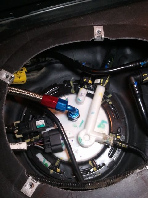

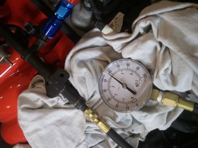

small update, got my bulkhead fitting. took the fuel pump out and put the bulkhead through the top where the pressure sensor was. moved the pressure sensor over an inch or so for room.
pressure holding steady

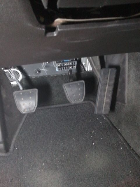

also mounted the c5 pedal, fit perfectly feels identical to stock

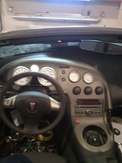

haven't posted any updates lately so here are a couple pics

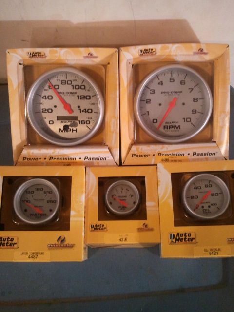

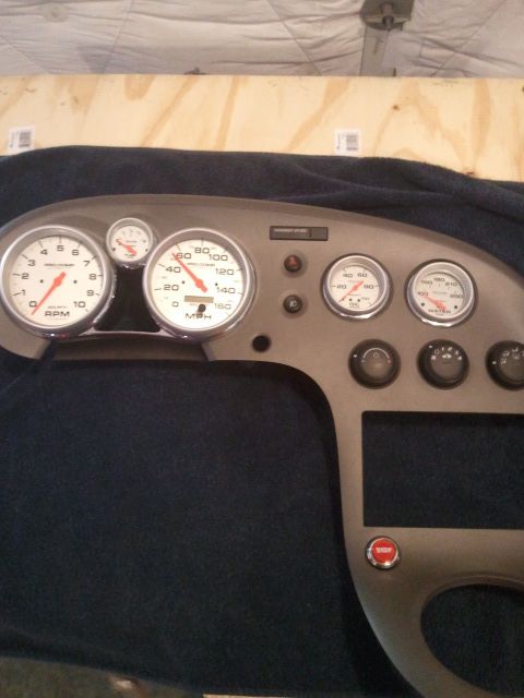

got some autometer gauges

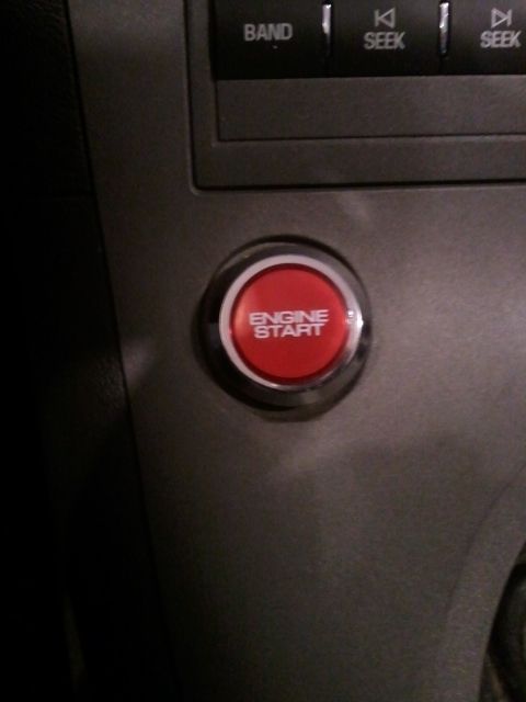

also added a push button start
i tried to load a short video of it running but wouldnt work, i guess ill have to research what im doing wrong.
still a few odds n ends to button up, i really want to go for a test drive but it seems the snow will not let up just ran it through the gears up on jackstands
next step is to put the front cover back on, make an intake tube/filter assembly, etc.

Those look killer

Great job on all of it. I hate our deep recessed fuel gauge. It would be interesting to see if you get unreasonable glare on the gauges though.
