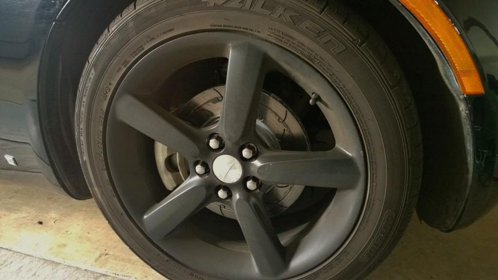

Okay, so I have a question related to my latest install.
On the old rotors and pads, the fronts developed a line around them. It happened after racing at Hallett MRC. I figured it was because I cooked the brake pads.
I have installed the new Hawk HPS pads, front and rear; and now the line is back on the fronts, even with the new pads and rotors installed. Any ideas?

Picture Please

Fronts:
Rears:

Guess...Just a guess
If your pads have a slot in the center pad material, it has filled up with crud when you bedded them in. I had this happen on some ceramics that I used. Took them out and cleaned the slot and they were fine. HTH

Sounds good. I'll take a look.

Problem seems to have resolved itself with some more hard breaking. Probably just needed to to get seated a little better.
