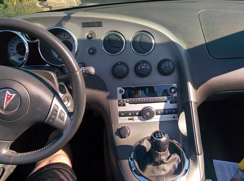

I picked up a UUI radio from a 2009 Cobalt for under $40 CDN. Total install took less than 45 mins.
Can't come to a conclusion if the off-colour is worth the USB port. Still debating on whether I pay to have the dealer unlock it or not.
Here is a pic anyways if anyone was wondering what it may look like:

Pull the faceplate off and paint it the right colour? If I remember correctly, it just snaps off.

My service advisor says he will do it for free if it's simple on the tech 2. I think he thinks it's like resetting the tpms, which it's not. From what I read it looks like 1/2 to one hour of labour. So looking at $60-120 CDN. All in I would be at worst case $160. That's cheaper than trying to buy and wire up an aftermarket unit. Thx sly Bob for the link to paint the face plate. That's a nice weekend job. Anyone have any idea on the paint code for the grey radio?

Do you think I could just swap face plates?
I would have to dremel out a slot for USB or run a USB out the back. No painting then?
My only issue is that the original radio was a 6 disk unit so it has a LOAD button under the FAV. I would either leave the LOAD button on or swap it with the clock button seen on the new unit.
Thoughts?

Yes, yes and yes.
I had three radios. My original non-Monsoon single CD. A used 6-CD unit that had the CD guts removed and a Monsoon UUI radio from a Sky. Originally I swapped my original faceplate onto the Sky radio (per the thread I linked) and that worked. Then I took apart and painted the 6-CD faceplate while I kept my original face pristine and just swapped the Load-Clock buttons. Then replaced the original with the painted faceplate. All combinations worked fine.
You'll find it pretty easy to check if the faceplates are physically compatible. Just a couple of screws on the side and then the unclip and compare (take the radio out of the car first).

This is a tough one for me:
Option 1:
Take the new radio out and paint the face plate. If I screw it up, no biggie - the radio is only $40 and I can repaint again.
Option 2:
Swap the face plates and dremel out a slot in the old dark face plate for the new USB port and swap some buttons. If I screw this up, 6 disk radio is a loss since its face plate will have a hole in it.
Both options require me to take apart the radios and delve into the face plates.
I think I am going to go with option 1. Once its painted I can put it back into the car. If it looks good, I go to the dealer and have it reprogrammed. If it looks like crap, then I go back to the old 6 disk unit and call it a day.
