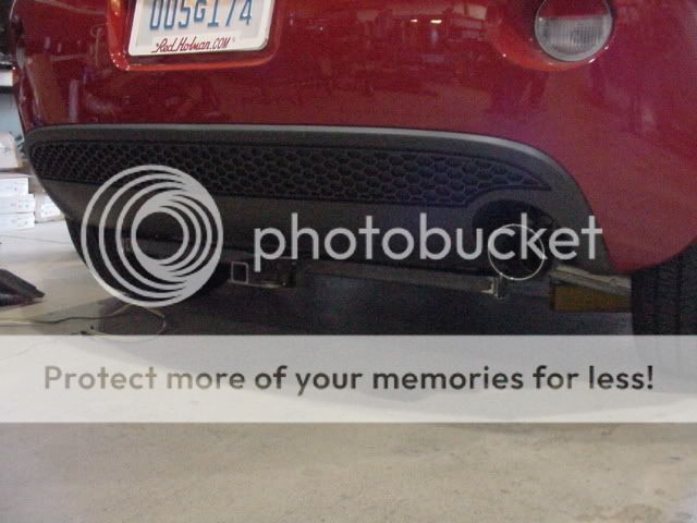

I'm a designer for Cequent Towing, Draw-Tite, Reese Hidden Hitch etc... I've just completed a new hitch that will fit the GXP dual tailpipe without modifying, (cutting) the hitch brackets, (like on the Curt hitch).
It is a strong hitch with a thicker frame bracket on the driver's side and reinforcement bars that was tested as designed, (unlike the modified Curt hitch).
The Draw-Tite part number is 24833. It should be available sometime in February 2009. Includes ball mount and pin and clip.
Call your local hitch dealer and ask for it.
Sincerely,
Lynn

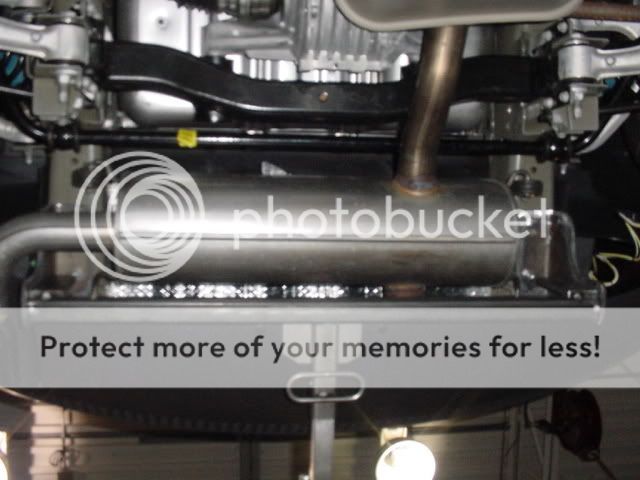

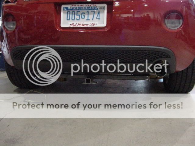

Originally Posted by Carpe Diem View Post
Several of us are wondering if your hitch will work on Sols (GXP's in particular) that have the DDM ProBeam installed.
Shouldn't be a problem. The hitch bolts to the unibody frame members further back than the ProBeam. See my underneath picture with the proto hitch in place. I would think that with the ProBeam & the Draw-Tite hitch both installed you would definitely control the torsion issues at high speed cornering.
This is shown on a non-GXP, but it still fits the same on a GXP with dual tailpipes.
