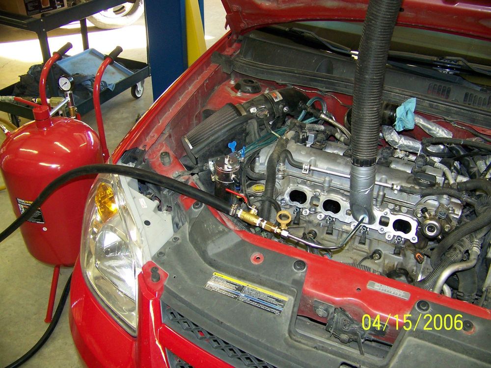

The cobalt lnf's have had success using these mini tools
https://www.ecstuning.com/Search/Sit...ction_Adapter/
Here is a pic
And a link to the thread
https://www.cobaltss.net/forums/08-1...tlanta-325238/

Thanks for finding that! Mini Cooper Extraction Adapter ordered!

@rob the elder the one I bought off eBay was $76 plus $5 shipping. The vendor is the exact vendor as who slaSh linked, ECS. If you found for $70, then you did better than me!
Mine will be available for any club members use once I'm finished with it.

Let's see some links to the eBay auctions you found. Also, is your purchase for BOTH tools or just the extraction adapter?
Check this link for both on ECS. https://www.ecstuning.com/Search/Sit...ction_Adapter/ Compare your total pricing, please. Notice no shipping over $49.00 and they have sales all the time.

The eBay item that I purchased from ECS is linked below.
I did see the adapter but decided that it wouldn't work for the gravity gun that I purchased. I have something else in mind that I might be able to rig up as an adapter for less than $5.
I'll be posting pictures when I perform the cleaning.
