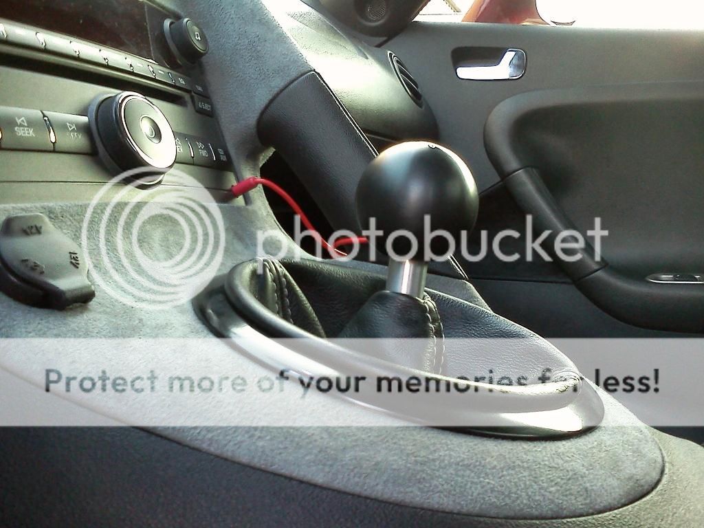

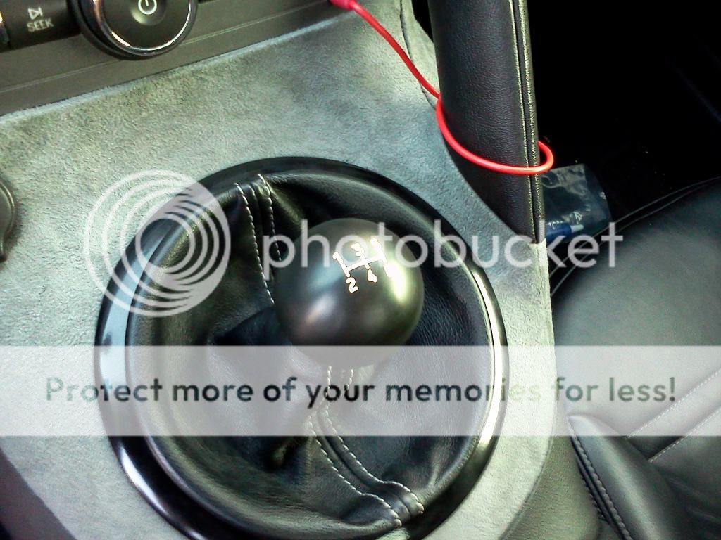

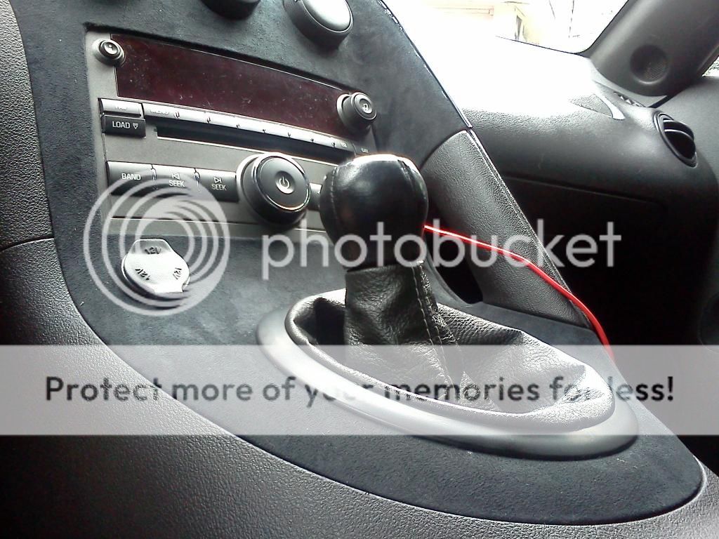

Hey guys. I check out eBay a lot, and I'm glad I do. There was a listing last week for a mint condition JPM shifter for 129.99, so I know I couldn't pass that up. I received it in the mail today and installed it within 45 minutes of getting the package. Boy am I impressed! I didn't realize how bulky and imprecise the OEM shifter was compared to this aftermarket one. Not only that, but it looks beautiful. Install was a breeze. The allen head screw came out within 30 seconds of me simply tugging. Anyone who is on the fence of purchasing one, just go for it. I couldn't wait to get off work today just to drive her :)
Before:
After:
