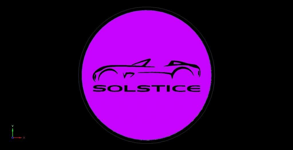

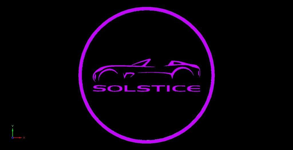

Getting ready to pull the trigger on these. Supplier cautioned me on my approach - purple foreground versus background.
Which one to you think will show up best / look best?

I like the bottom ones better!
Not sure about the purple :))) but the second one looks better. If however, you want them as puddle lights, then the first would be best, since it gets more light on the ground.
