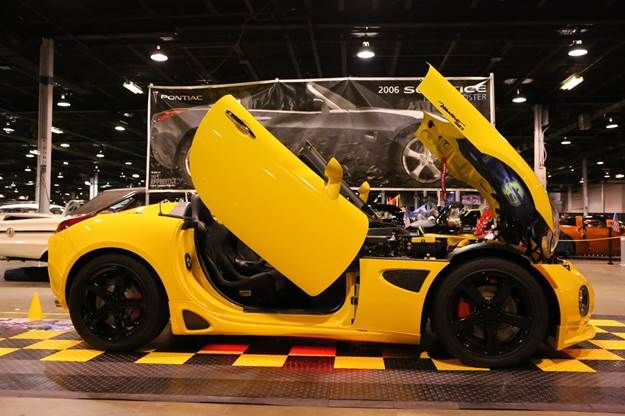

I have the same race deck.they look new after several years. When I do damage one, which happens if I drop something very heave on my foot... The tiles are very easy to replace. Mine stay very clean. I vacuum them and occasionally use Adams VRT on them.
You can see the floor in the pics I just posted in the Punisher thread

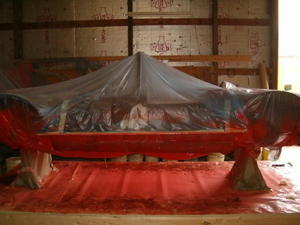

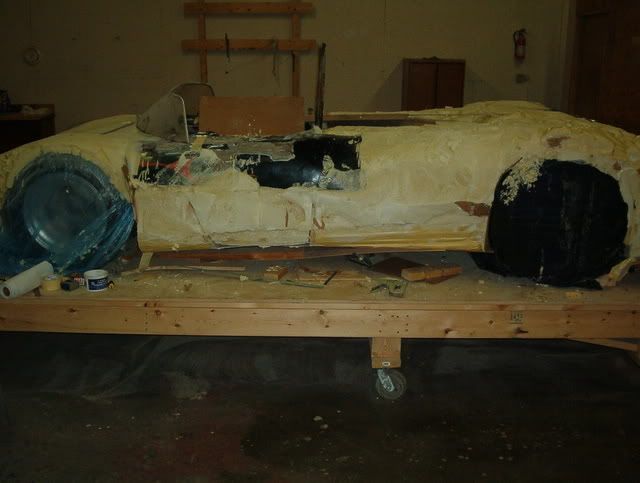

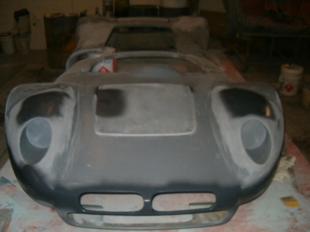

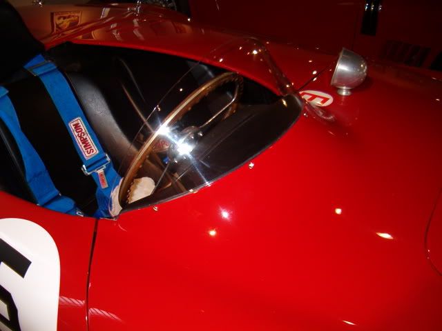

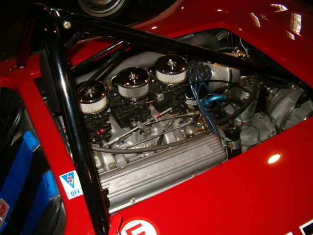

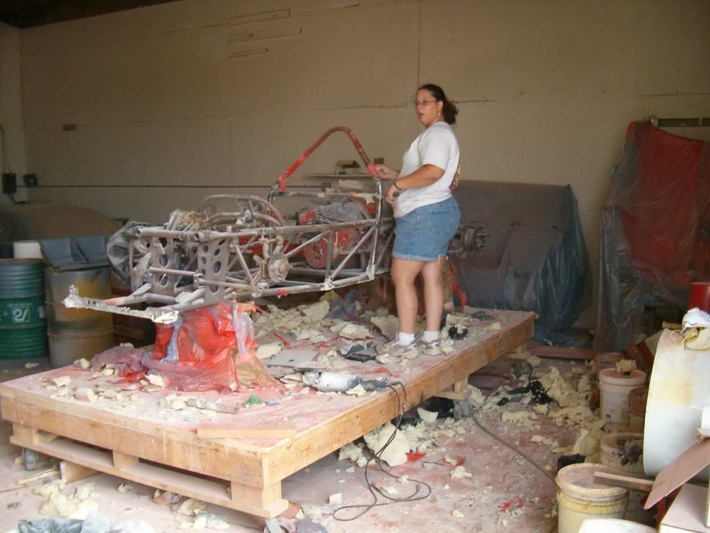

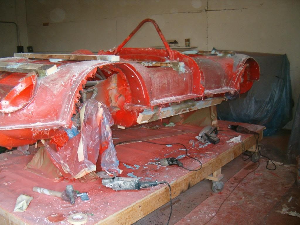

Can Am car I did for a customer.
Norm, not a Canam car, it obviously predates that series, but looks like a really cool A or maybe B sports racer from the 60s. What is the chassis? (You can probably tell I've spent a lot of time in vintage racing!).
On the floor issue, either use bare concrete and ignore oil stains (or don't ignore them and waste/spend a lot of time on trying to clean it) or apply some commercial coating, but bear in mind that the cost is directly proportional to the performance of the coating. A good friend who had a half dozen cars in his stable opted for a coating that was a 'good buy' and wound up having to stick heavy paper squares under the tires of his cars because they stuck t the coating and lifted it (for months after it was applied!)
1,453 Posts
Hello, yes youre correct. I just say that to say that. The car was featured in Car Craft Magazine 1960 not sure of the month without looking it up. The chassis is a tube frame with a hewland rear transaxle 283 chevy 3 carb Wieland setup. All I got from the customer was the frame as I made the body from scaleing up the pictures from the mag. It was sponsored by Dan Blocker from Bonanza fame. Thanks Norm

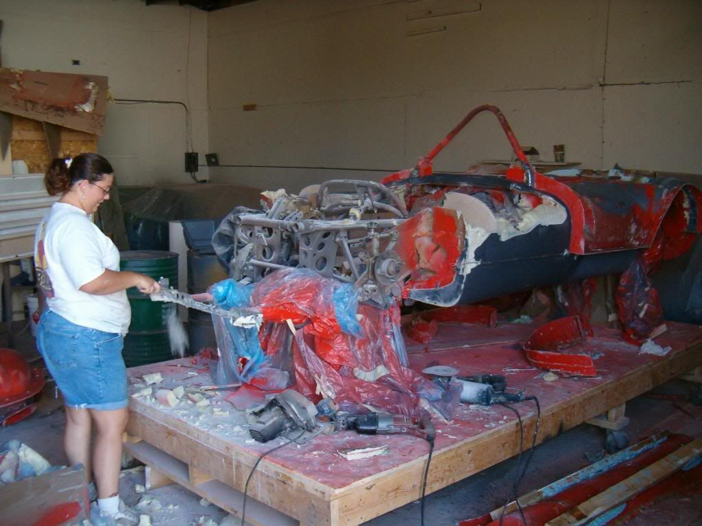

That's me.

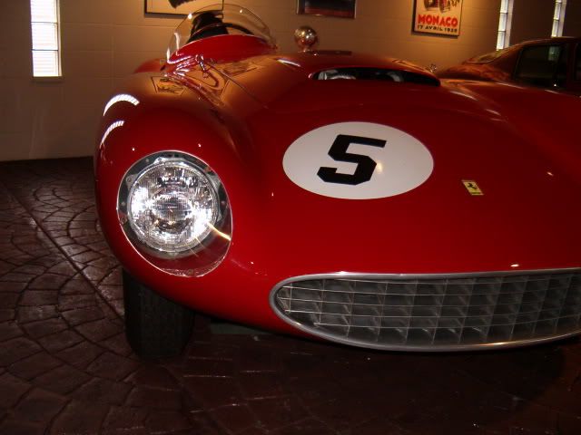

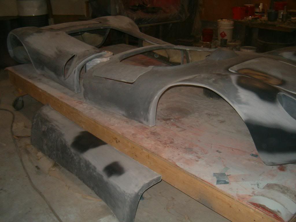

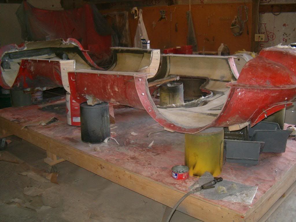

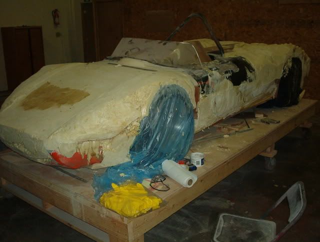

A few more of his cars, that I did a little on, for example making that Ferrari 500 front windshield and headlight covers.
Wow. All I can say is it sure does not start out pretty does it. that thing is immaculate and I praise you for your excellence. I've always considered myself a pefrectionists but you are on a whole nother level my friend. Nice work!
1,453 Posts
Hello, youre right it doesn't start out pretty at all. Once the multipiece molds are done then the foam and bondo patterns get destroyed leaving the bare frame. Once the molds are finished then you can make parts, sounds easy!
