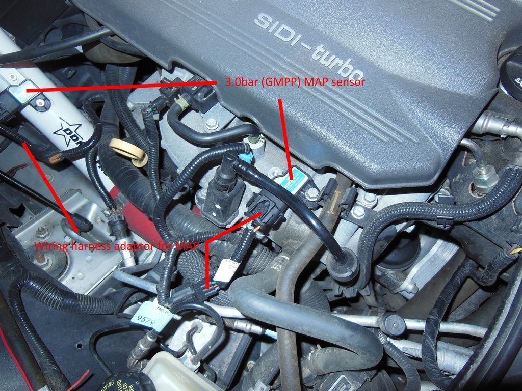

Looks like you have the adapter wire harness. Which would mean you don't have to worry about the crimped wires.
7,505 Posts
Heh! I don't think that his picture! :)
Yes sirwm, you are in the correct area. The crimps are in the wires a few inches out from the two MAP sensors noted in the pic.
the picture is in first post is a picture I found. It is not a picture of my car...
4,902 Posts
You can see my photo of the butchered job my selling dealer made of my install, over on the KP forum (you'll have to be logged-in to see the pics), here: FYI - Removing pins from GMPP TMAP connectors

Good picture tomato! Yes that is what it looks like when crimped together by dealer. I soldered on both my cars and haven't had an issue since. Get it fixed Sirwm.

The crimps are special connectors GM uses and they are not foolproof. I soldered my connections and shrink tubed them before taking the car to the dealer for the retune.
could you post a picture please of what you soldered ?

Jeez, you didn't get the message from the pics above??
YES. You DO need to solder. Undo the electrical tape and peel back the wire covering. You'll see the crimps.
