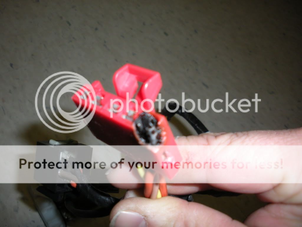

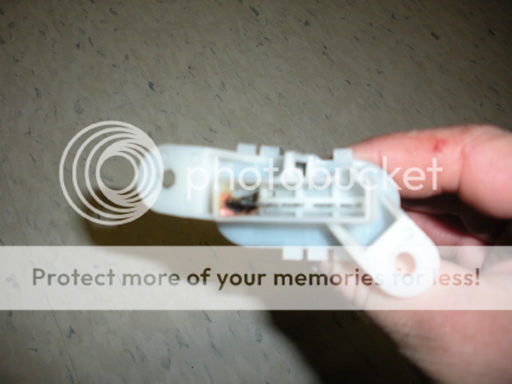

so about a week ago my heater/AC blower stopped working and of course it was on a day it was about 20 degrees out i was like WTF over. well i went and got a used blower motor thinking it would be that as with this issues ive had with other cars it was the blower. a new one cost like $160 so i got a used one for 70. i took the glove box off and the panel under the passenger side dash and pulled out the blower and plugged on the new one and nothing. i then jumped the old one on a battery and it worked like a charm so i checked the resistor all looked fine so i checked the connection and well after 15 min of fighting with it to get it apart i discovered why. the connections melted. so basically 1 blower harness $49 (only from gm) and 1 resistor from GM for $38 and she runs like new. here are the pics of it.

You usually get this from a bad or loose connection. Loose connections with high current get hot. Good find!

You only need to replace the resistor (presumably) because the connector is burnt, not the resistor itself. So no need to replace the motor.
Don't know the resistor part# but the harness number is visible in the photo above... 25797383

The hardest part for me was to get the connect apart from the resistor as it had melted and fused together with the resistor body.
I did not replace the harness, just the connector as I found the same connector from a junk bin at a GM dealer. I had cut the connector off anyway because I could not get the connector and resistor apart until I had them out of the car.
The connector that I found had long leads still attached which allowed me to splice it back to the cut off leads giving me a longer harness so there shold be no repeat of the problem (I don't know if you bought a new harnes from the dealer if it has been made longer to prevent the original problem).

Just a comment. I'm a civil engineer, not electrical, so I was wondering if that is a "heat fuse" soldered on the left end of what I take to be the resistor...that green thing? Did it blow, or was it the melting of the connection itself that stopped the motor?
563 Posts
Discussion Starter #13
it melted the connector due to a poor connection
