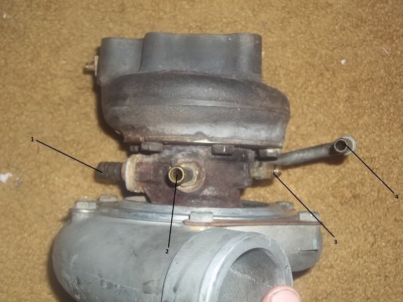

So as most of you know, I'm not super experienced with turbos, So i want to make absolutely sure I have the coolant and oil lines correct, could you guys tell me from this picture which are the coolant and which are the oil?
4 and 2 are coolant and 1 and 3 are oil right?
By the angle of the picture -
1. Oil Drain
3. Oil Supply
2. Water
4. Water
