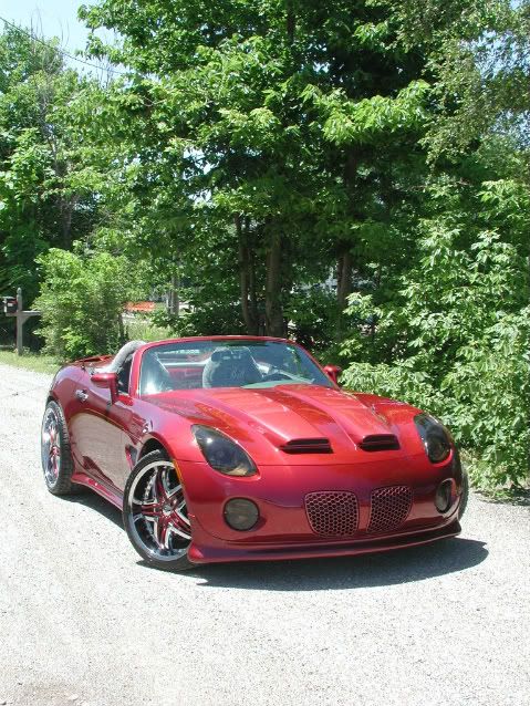

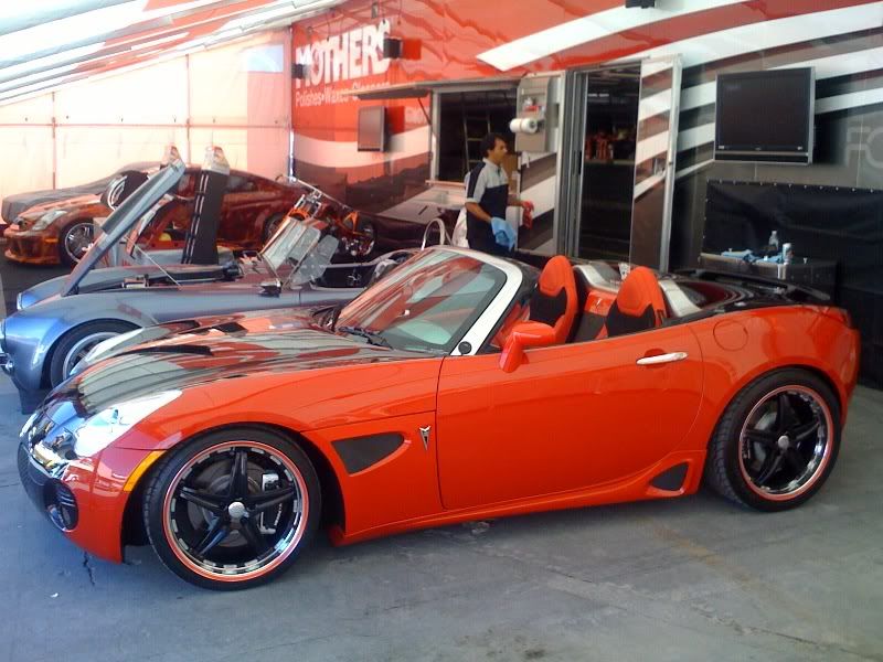

hello, Whow and Rob youre the man again.
heck yes get the GXP! Faster than Porsche Boxer S, BMW Z3 4 better handling stock than a 350 Z. Plus they are and always will be "hey is that a Porch" at the local fuel stop. LOL.
Oh and you can make it go even faster!

Norm! When can we see and buy that new hood? Lot of guys around here are thrilled about it.
