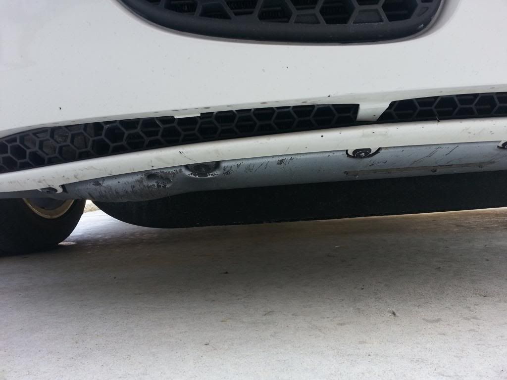

Have a question for everyone. I live in a sub with "gutters". Mine are rather small compared to most in here and I'm having a problem. I have managed to bend it a little more..... Do I have to replace the bumper if I want to fix it? Nothing is broke plastic wise. It has been like this ever since I bought it....
Here's a pic.....

The lower black honeycomb grill has been pushed back & out. Unless that's broken (can't tell from the photo) all you need to do is take all that lower bit apart and re-install in in the correct place. Should be fine.

I'd bet the 2 little metal arms that go down to support this may have been bent up some too, so setting those back straight will help.

You can access the entire area behind the lower grill if you remove the upper grills. You can also inspect for collateral damage easier:( The upper grills should pull right out if you're carefull and work on one edge at a time:thumbs:
