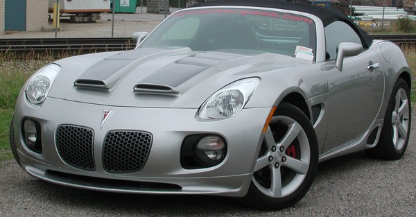

i looooove the look of Norm's "front splitter" here, but is it the entire bumper cover or just the lower part with the splitter? (http://www.normsfiberglass.com/images/sol/gxp-grd/gxp-grd01.jpg) His site doesnt really have any information and I dont even seen a place to order the parts online.

Hello and thankyou for the kind words, just call me is best.
The splitter will cover up your damage, though you may need some support braces underneath that lip area.
To be honest, how you drive and where you drive may not work for our splitter in the long term. Not to be a smarty at all its just that you will have to park short as the splitter protrudes out. It wont go over a parking curb, but then again neither will a stock bumper as you have found out. Just give me a call. thanks again Norm
