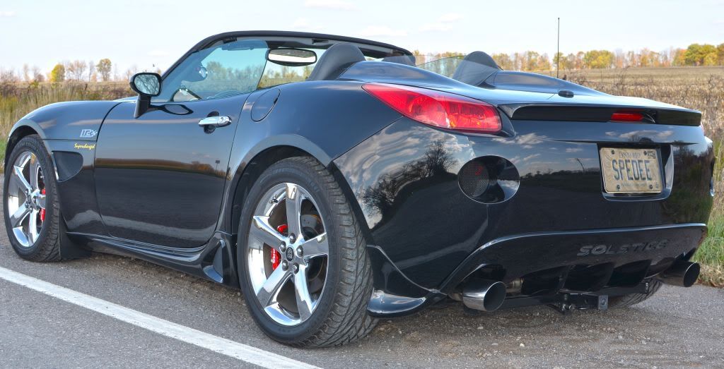

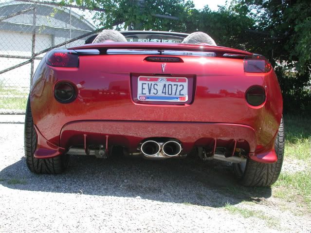

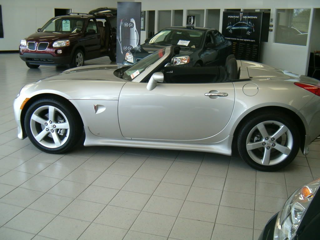

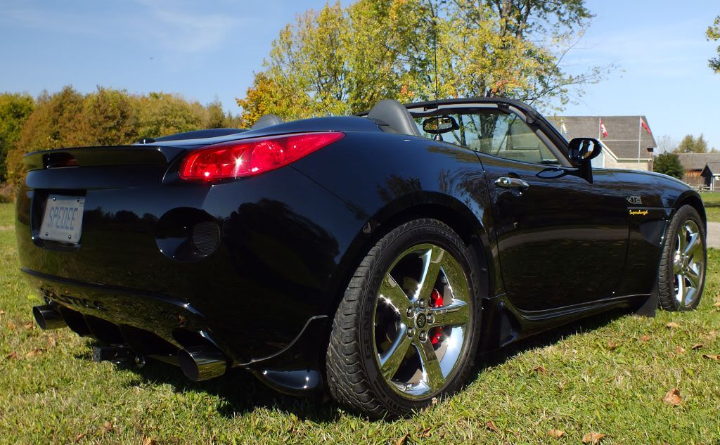

Agree with Rob & Northern Sol go with the factory ones they look & fit great I have them on my car. Crate Engine Depot carries them for 42.50 a set and they are genuine GM parts.One thing that I did when I installed mine was putting some black door edge guard (the flexible stuff that comes in a roll)around the part of the flap that touches the body panels .The flaps themselves are pretty rigid and this prevents them from rubbing off or scratching your paint and you can't notice it. If you want to see what they look like on a car just click on my avatar and you can get an idea .

This is a good idea. I have the flaps and the bottom has pushed up going over speed bumps (they are rigid) rubbing against the body paint.

You might also want to try a thin foam stick on for the part of the flap that runs along the body. Over time you'll get road debris between the flap and body and it will scratch the paint without the foam. When we bought our car we had the flaps, and I removed them. I did some paint cleanup, but if you look carefully with the sun on it, you can see where the flaps caused a little scratching on the fronts. We just have the clear protective tape for the rockers now.
