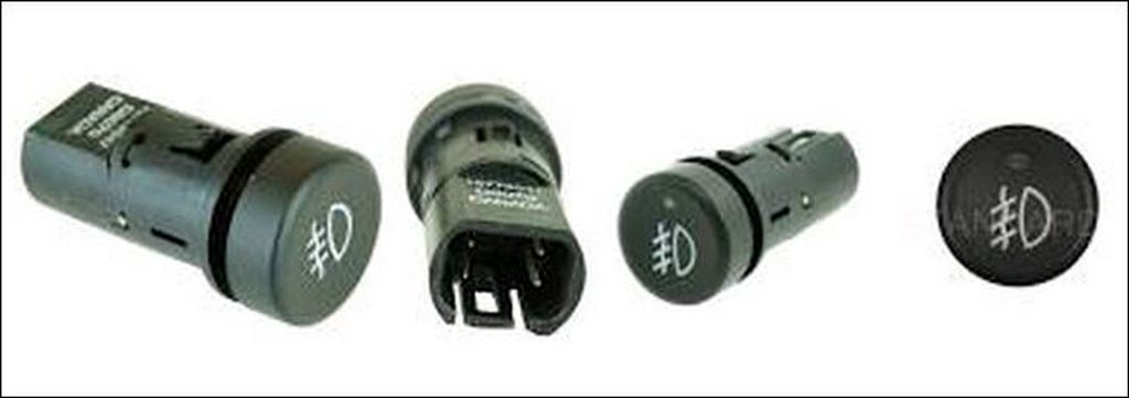

To fix problem #2 I have already bought the switch below. That is a real good start I think :)

I have a rear fog lamp switch for an Opel GT and it appears to be the same as the normal front fog lamp switch used in the Sky and (I am guessing) the Solstice. Since it supplies a momentary signal to the BCM, it cannot be used to directly control a light.
715 Posts
John, thanks for quickly chiming in. So I'd have to either mod the switch to become a permanent (as opposed to momentary) switch or use a flip-flop circuit.
Apart from being the same as the front fog switch I imagine it has the correct icon for rear fog (ie. "flipped" compared to the front fogs)? Thanks
I think the flip-flop circuit will be a lot easier than modifying the switch, unless you can find a similar switch with the latch mechanism that you can exchange caps with.
A good question about the icon. I bought the two-switch panel and switch "because they were available" but never really looked at them because I didn't actually have a use for them at the time.

I checked on the switch that i bought and it is still available 2006-2010 Solstice SKY Opel GT Rear Fog Light Driving Light Switch New 15773547 | Factory OEM Parts :
Font Camera lens Lens Camera accessory Cylinder
It looks like the same icon, but maybe it is installed reversed? I don't actually know what mine looks like, as it is pretty much out of sight, but I did look at the owner's manual illustration:
Thanks. The icons are reversed (at least that's what I always found in several European brand cars I have owned). I noticed it seems the button you have has no telltale LED like the Solstice front fog button does. It might be because of some rule in Europe requiring a telltale light on the instrument panel. Maybe the Sky also works that way (fogs on/off indicated in the cluster instead of the button itself)?
Anyway some googling gave me a good short answer on the difference between the icons for front and rear fogs:
Sky Font Magenta Brand Darkness
Cheers
Cheers
Yes, the Sky has an indicator in the IPC, it would be interesting to see what the Opel GT has, ie: one or two.
So the Solstice switch is different, is it a maintained switch? If you leave the fogs on when you power the car off, are they on when you power it back on?
Hmmm, I wonder if the FactoryOEM description is wrong, or if GM elected to ignore convention and labeled both switches the same.
I have messaged an Opel GT owner on the Sky forum, we will see if he has any answers.
