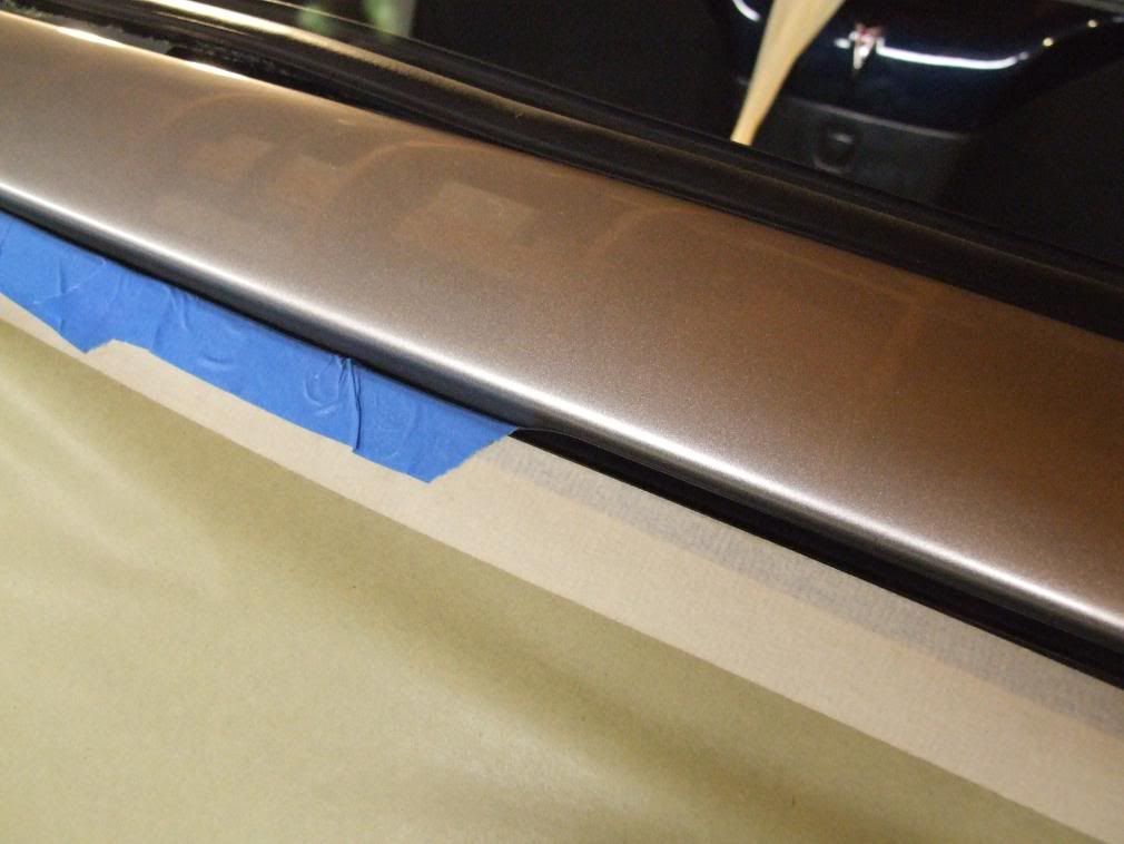

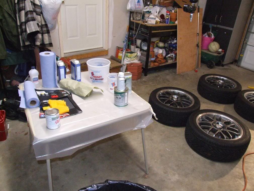

Ok, last weekend I painted Lil Goats yellow, this weekend he helped me prep mine and I painted 5 coats of blue and 2 clear
Taped off windshield and disasembled a little bit behind seats and taped off the back of the car. Taped off the rims and then wet sanded everything with 400 grit. The rims were a complete pain in the but to paint due to all of the angles.
Car ready to paint
Tim had a great idea to cut carboard to fit inside rims from the underneath side to prevent overspray.

Deepbluegxp is out cruising the mountains, but it can be done in 1 very long day. It is the masking that takes forever, the painting goes pretty quick. The car is actually easier to do than the wheels were.
4,143 Posts
Discussion Starter · #20 ·
I started masking about 8am on friday. Took about 2 breaks, started sanding about 2 pm, painting about 3:30 pm, finished painting about 6:30 pm. Lilgoat took most of the photos and helped mask and sand oh ya, supervised :lol:
