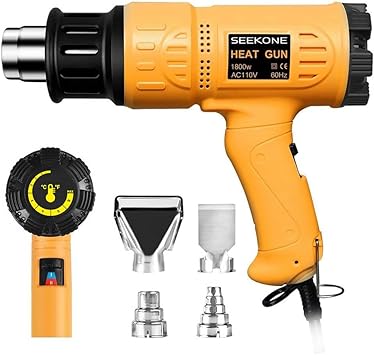

#5 ·
Here is the heat gun I got off Amazon. For $30 it works great!
